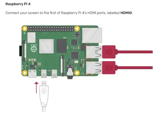

If you are using Pi 4, make sure you connect to exact HDMI0 port as shown in the picture. Otherwise, you will see a static rainbow image on the monitor.enter image description here
