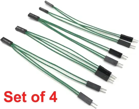

All I could find was these splitters on Amazon, which would allow me to connect two devices, assuming the pins are the right size (as it happens the pins I need are next to each other):
splitter product

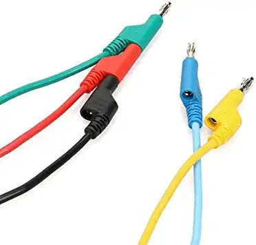

I was hoping for something that could be "stacked", like these banana plug jumpers but obviously smaller:
stacking banana jumpers
