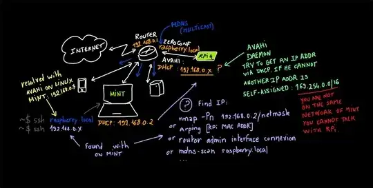

Assuming you have correctly written your image on your SD card, here is schematic about how zeroconf work (as specified by @tpack) if you want contact your raspberry with raspberry.local name. Maybe this can help you better understand. Normally if the OS is correctly written and started RPi must obtain an ip addr on her ethernet interface when you plug your Ethernet cable from your raspberry to your router. If you get this IP address you can communicate directly without needed the mdns name record and associated mdns services/daemons. Somes network 'methods' are used for getting an IP addr (purple notations) from a remoste host located on the same network (for you, your Linux Mint). Also, some firewall block ICMP packet type (use -Pn with nmap for example, you can add -p 22 for checking only hosts with SSH port opened). For Arping tool you must know your RPi M.A.C address.
Possible errors :
  • The image was badly written on SD card.
  • Your router dhcp service have assigned all there ip addr and cannot assign a new ip addr.
  • Problem with AVAHI daemon on RPi : self-assigned ip addr, your are not on the same network of your Linux mint.
  • Problem with AVAHI daemon on Mint : not started, he cannot resolve raspberry.local name record.
Network Zeroconf:
