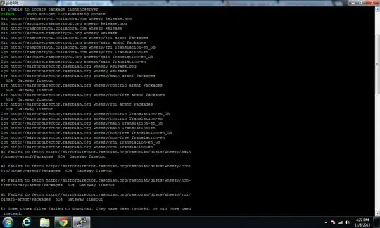

I am trying to install tightvncserver on my rPi model A running Raspbian. I am connecting to the rPi via SSH from my laptop. I can connect to the internet, but cant install the package. It seems to be a problem with mirrordirector.raspbian.org because that is where my rPi runs into trouble. Is anybody else running into this issue or found a solution? Searching this site seemed to show that I am not alone in this, but I couldn't find a resolution.
I've tried
sudo apt-get update
Screenshot: Screenshot for sudo apt-get update
but it takes forever when trying to reach mirrordirector.raspbian.org Every time I try it says "XX% [waiting for headers]" for several(30+) minutes before finishing with an error message.
I've tried pinging mirrordirector.raspbian.org with both my rPi and laptop, and both tell me its unreachable. When I try to go there with my browser(on laptop) it gives me error 504 gateway timeout.
Edit: I tried wget mirrordirector.raspbian.org and it gave me a 504 error... Is anybody else getting this error? wget output on rPi
Should I change my sources.list file? it contains
deb http://mirrordirector.raspbian.org/raspbian/ wheezy main contrib non-free r$

Please note this answer is out-of-date and the current version of Raspbian is jessie, not wheezy. Make sure of which one you are using before you do anything.
Your raspbi could not find a valid mirror so you need to find a working mirror. For valid and working mirrors please check http://www.raspbian.org/RaspbianRepository
After getting valid mirror address you need to add this mirror url to your /etc/apt/sources.list
for example your sources.list file should look like
deb http://archive.raspbian.org/raspbian wheezy main contrib non-free
deb-src http://archive.raspbian.org/raspbian wheezy main contrib non-free
and then you need to update apt sources
sudo apt-get dist-upgrade
finally update your raspbian or do whatever you want
sudo apt-get update

I had a similar problem. It turned out that the network I was on required http requests to go through a proxy.
Usually typing the following before accessing the web will work:
pi@raspberrypi ~ $ export http_proxy="http://username:password@host:port/"
(where username:password are your username and password on the proxy, host is the name of the proxy and port is the port on the proxy. If you don't need to login to the proxy, you can leave off the username:password@ part.)
But it turns out that apt-get doesn't understand the http_proxy variable (for security reasons.)
Instead I followed the directions at http://www.raspberrypi.org/forums/viewtopic.php?f=28&t=18634
pi@raspberrypi ~ $ cd /etc/apt/apt.conf.d/
pi@raspberrypi /etc/apt/apt.conf.d $ sudo nano 10proxy
Within the nano editor type the following line:
Acquire::http::Proxy "http://username:password@host:port";
Then use ^X (Ctrl-X) to save and exit. Now
sudo apt-get update
should work.
Hello I had the same problem , I found out that in my case it is my netgear router which is blocking all ip adresses in range 5.x.x.x
so raspbian.org is blocked (I also tried www.pure.com) same result netgear is abusing range 5.x.x.x for readycloud function , very bad !!! I solved it by using wifi access in other place (without netgear router)

Some of the answers to this question are out-of-date now that the current version of Raspbian is jessie, not wheezy.
The content of /etc/apt/sources.list has changed accordingly. Here it is as it appears in the 2016-09-23 image:
deb http://mirrordirector.raspbian.org/raspbian/ jessie main contrib non-free rpi
# Uncomment line below then 'apt-get update' to enable 'apt-get source'
#deb-src http://archive.raspbian.org/raspbian/ jessie main contrib non-free rpi
I had this problem with mirrordirector.raspbian.org and solved it by uncommenting the last line. Strangely, this was only necessary on one of the two SD cards I installed.

I had the same(?) problem with mirrordirector.raspbian.org. I booted a new image and made a wifi connection while in the raspi-config gui. I logged out to the console and tried apt-get. No luck. In fact no internet at all. Exiting the gui killed the connection. I rebooted and this time internet working, apt-get working.
user16300
I had the same issue and found that the issue was that my /etc/resolv.conf was pointing the nameserver to an old IP address that was previously used by a workstation on my network (No idea why) after correcting that to my DNS server on my network all was wel
