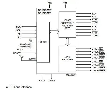

You can buy a SC16IS752 that uses I2C - Which means you can add a few of these with real time data flow. It is more complicated since you have to build everything around it your self.

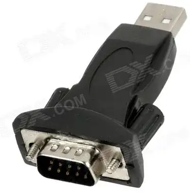

You also buy cheap USB to UART - a USB Hub and add as many as you like
