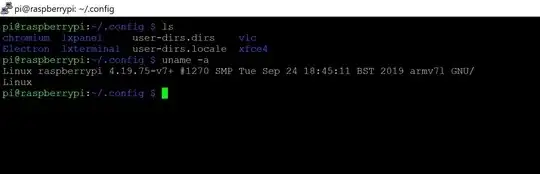

I am running the following os image on my pi 3 model b:
Raspbian Buster with desktop and recommended software Image with desktop and recommended software based on Debian Buster Version:September 2019 Release date:2019-09-26 Kernel version:4.19 Size:2541 MB
I am trying to make some modifications to the autostart file to keep the screen from going to sleep by running the command sudo nano ~/.config/lxsession/LXDE/autostar" but there does not exist a folder named lxsession in that directory.
Could it possibly be that there exists an lxsession but it is hidden? Please advise.

If you just want to prevent your Pi from going into sleep mode you could just change lightdm which manages sleep mode.
Go into the config file:
sudo nano /etc/lightdm/lightdm.conf
and add the following line:
xserver-command=X -s 0 dpms
Edit: I just noticed you're probably following a guide for the Raspberry Pi 4 where indeed that directory and file exist. But the Pi 3/3b need another approach if you want to get something into auto start.
Regarding your missing directory I think that you are searching for:
/home/pi/.config/autostart
and there you need to create a file which does what you need it to do but I only created .desktop files, so I'm not quite sure what type of file you need.(Probably a .desktop file that executes some command)
