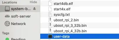

Once you have your Ubuntu (20.04 in my case) installation ready in your USB, edit the user-data file
Under the section ## Install additional packages on first boot, Uncomment packages, and add a new entry for the openssh-server package.
For example:
packages:
- openssh-server
Five minutes (more or less) after my Raspberry Pi 2B boot I was able to connect to my Pi 2 through ssh :)
