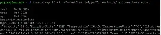

I am trying to execute my program when my Raspberry Pi boots up with time sleep 10.
it workt only with time sleep: "time sleep 10 && ./DotNetConsoleApps/Tinkerforge/helloweatherstation" enter image description here
but it didn“t work when i try to start it on the Raspberry boot. Like this: "@reboot time sleep 10 && ./DotNetConsoleApps/Tinkerforge/helloweatherstation" enter image description here I need your help please
