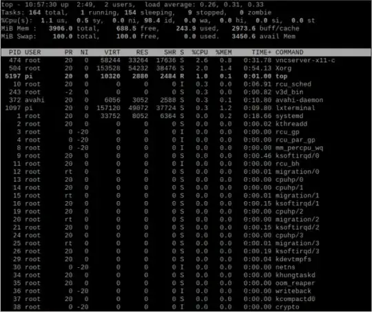

Edit: The output from top can be found below Output top Here is shown that the Pi is running out of free RAM and the cache/buffer is filling with RAM. However I feel the Pi is getting slower and slower. Eventually I get a error in my python script that it's unable to concatenate str and NoneType in the copyfile function. I suspect this happens because the Pi ran out of RAM and can't save the latest filename to the variable LatestVideo anymore.
