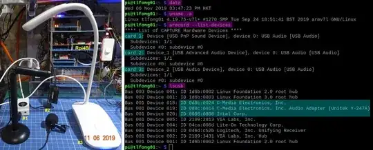

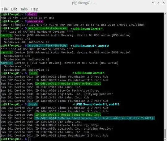

I have two USB sound cards. This is how I identify them:
(1) Plug in one sound card - #1 and (a) $ arecord --list--, (b) $ lsusb,
(2) Plug in one more sound card - #2 and repeat Step (1),
(3) Note the IDs of #1 and #2 USB sound cards.
sound card ids
