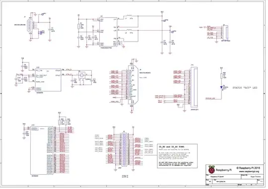

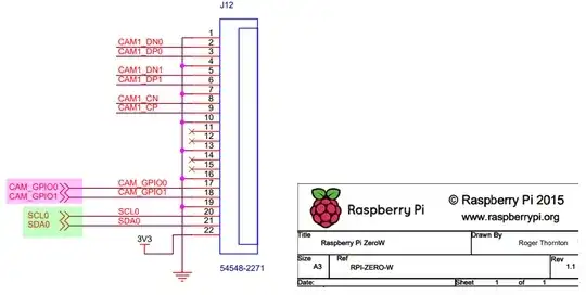

I found this diagram, which on the middle row, right column shows that the CAM1_DN0, CAM1_DP0, CAM1_DN1, CAM1_DP1, CAM1_CN, CAM1_CP, CAM_GPIO0, CAM_GPIO1, SCL0, and SDA0 pins join some connector, but other than SCL0 and SDA0 none of these names match pins on the pi.
Raspberry Pi Zero Schematic

CAM_GPIO0 -> GPIO44
CAM_GPIO1 -> GPIO40
(ref https://github.com/torvalds/linux/blob/master/arch/arm/boot/dts/bcm2835-rpi-zero-w.dts line 87 91)
SCL0 -> GPIO29
SDA0 -> GPIO28
(ref https://elinux.org/RPi_BCM2835_GPIOs)
