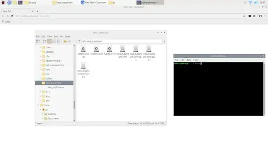

I ended up creating several wpa_supplicant.conf files as I was a bit confused initially what the process did. enter image description here
I have several of these files and I don't need them anymore. I tried to delete them manually just to see what would happen and I got a permission denied warning. On top of that, I wasn't able to even connect to my hidden network, so I ended up making it visible and connecting to it that way. If anyone has suggestions as to how I can remove the config files, or if I should just leave them be, and how I could properly access hidden networks, I would greatly appreciate it.

To delete restricted files you can use rm in combination with sudo (execute with root rights). So to delete wpa_supplicant.conf you can execute on the command line:
rpi ~$ sudo rm /etc/wpa_supplicant/wpa_supplicant.conf
Repeat that with the names of the other files you want to delete. But you need wpa_supplicant.conf to connect to the hidden access point. Just recreate /etc/wpa_supplicant/wpa_supplicant.conf with the content you have shown in the question. That should do.

It is difficult to see what you have done (post text not illegible pictures) or how you actually created multiple files, but /etc/wpa_supplicant/wpa_supplicant.conf is owned by root.
It can easily be deleted at the command line with
