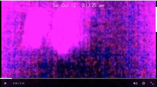

I have recently tried a NoIR camera in my new appartment and started getting this strange interference, see photo below. I comes and goes randomly but happens mostly at night in a dark room. Sometimes it can go on a whole night, every minute or so, and sometimes just for minute.
I have used the same setup on a Pi0w and on a Pi2+ before without this problem and I do not think the software has changed.
Could this be some sort of magnetic interference or should I be looking at hardware or software issues? What can I do about it? enter image description here
Yes! Thanks @Dougie
That seems to fix it.
Apparently there is a new AWB algorithm to accomodate the Pi4 and this screws with PiNoIR cameras on older pi's The whole discussion is found here: https://www.raspberrypi.org/forums/viewtopic.php?f=43&t=245994
By now it seems to be included in the standard upgrade. I ran sudo apt update && sudo apt dist-upgrade -y as Dougie suggested and have not hade any problems since.
So all cred to Dougie and guys on pi-f
