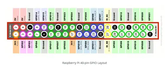

The raspberry pi 4 has at least two uarts (as shown here), I know where I can connect to one of them. Pins 8, 10 and 12 have a uart as an option.
enter image description here Source:
This site describes accessing uart1, where is it? Do I have access to it?
