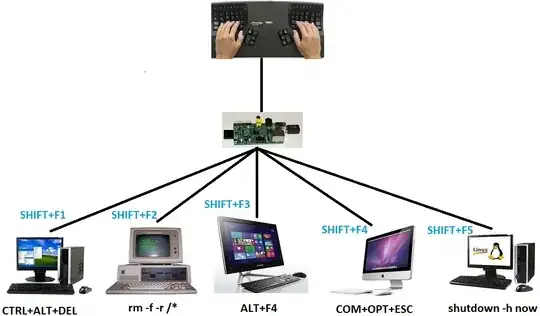

I have around 5 computers, and having 5 keyboards is 4 too many for me right now. What I want to do is connect my Kinesis Advantage (wired) keyboard to my raspi, have the raspi redirect all incoming keystroaks to one of the 5 computers, and toggle between the selected computer via shortcuts (ie. SHIFT + F1 through toSHIFT + F5), observe:
keyboard signal redirects

Have a look at Synergy. I've been using it for 4+ years daily between an Ubuntu box and a Windows one. Granted, it wasn't for gaming but I haven't noticed lag.
