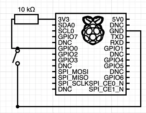

I have few switches connected to Raspberry Pi inputs. Internal pull up resistors are enabled. When I connect pin to the ground Raspberry Pi behave fine - pin state is low. However when I disconnect the pin from the ground it randomly change the state every few seconds. I have tried to add external 10k pull up resistor but it haven't worked. Pull up resistor is connected near Raspberry Pi. Switch is connected by 7 meters UTP 5e cable. I use pi4j library. enter image description here

If you are actually using GPIO0 (pin 27) this is actually SDA.0 which is used to control HATs and is marked reserved on official documentation.
I believe on newer Pi models this I²C bus is also connected to on-board extenders so is used for other purposes, although this is not documented, expect the voltage on this pin to change unexpectedly.
Use any ot the other pins (and a low impedance circuit).
