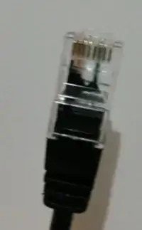

The splitters RJ45 plug only has 2 pair (4 conductors) connected. From left to right, pins 1, 2, 3 and 6 are connected. My understanding is this limits the connection to 100mbit/sec fast ethernet, but that's OK. I don't need speed, just a reliable connection.
rj45 plug
