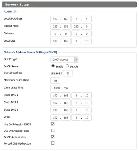

I have a piHole set up on my network with address 192.168.2.10 My router is 192.168.2.1 and the DNS settings on the router point to 192.168.2.10 meaning all traffic that goes via the router (which is everything) uses the local pihole for DNS (see screenshot below)
The router's firmware is DD-WRT v3.0-r33413 mini (09/27/17)

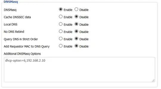

I had to also made some DnsMasq changes on my DD-WRT router as follows
and now I am able to ping and nslookup router.lan from devices on my network. However, I am not able to ping or nslookup router as I get ping request could not find host router. Please check the name and try again.

Relative to where you started, here are some issues that I think were part of your problem (and have been written into your updated question now):
  • The router was providing multiple DNS servers. Although your internal server was listed first, this is not a binding order of search on the router. See, e.g., https://superuser.com/questions/1177175/change-dns-search-order-on-mac-el-capitan, including the answer and comments. (Although the question started about Mac OS, the answer ultimately gets into the standards that apply to all clients.)
  • The Windows machines, and likely other machines, are using your router as their primary DNS. That's potentially OK as long as the router forwards those requests to your PiHole, which is what you accomplish by listing only that DNS as an option to your router.
  • The host names were properly resolved when you forced nslookup to use your PiHole directly. That suggests that the PiHole is properly functioning and you have some other network issue involved.
