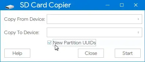

When you made your backup, did you select New partition UUIDs?
screenshot of piclone
If not, that's likely the problem. SD Card Copier help says this:
Under Raspbian Stretch and later versions, you cannot mount two partitions with the same UUID, so you will not be able to mount a cloned SD card when booted from the disk from which it was cloned. If you need to do this, check the "New Partition UUIDs" box before copying.
You can change the UUID with this command:
sudo tune2fs /dev/sdb2 -U random
After that, unplug the microSD adapter, then reinsert it. It should auto-mount from now on. If not, try rebooting.
