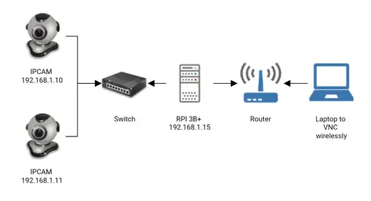

I would like to connect 2 ipcams via a switch to the RPI 3B+, and use the WiFi to connect to a router (to use the webbrowser etc), and also use the router for VNC
The ethernet is used to send commands to the camera and also watch the streams.
What is the best way to make this possible ?
Can I use the ethernet and WiFi at the same time ? Or do I need to set the switch to 192.168.2.xxx and the WiFi network at 192.168.1.xxx
Or do I need a separate DHCP server ?
Networking image

This problem can be reduced to make the RasPi a router with an WiFi uplink to the local hotspot/router and connect to a local wired network. It is no problem to use the wired and wireless connection at the same time because you asked it. If you mean to have all devices on the same subnet 192.168.1.0/24 then it isn't possible. For this you have to use a bridge on the RasPi but the WiFi device on the RPi does not support bridging of a client connection. For further information look at Raspberry Pi WiFi to Ethernet Bridge for a server?.
So you have to use routing with two different subnets and because you want to connect to the cams from outside the local wired LAN you cannot use NAT (Network Address Translation) to simplify configuration. You must configure your internet router with a static route to the wired network.
