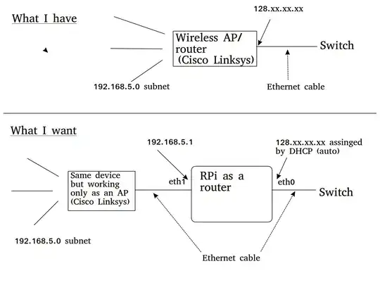

My aim is to use a RPi 3B+ as a router with an existing wireless router connected as an access point. The following figure explains this:
'eth0' is the Rpi's WAN port. The IP for eth0 is assigned automatically by a DHCP server that is beyond my control.
'eth1' is an 'USB to Ethernet' adapter. The wireless network is separated from the network the switch is in, by a NAT service that should run on the RPi.
I am following this tutorial as a guide. I have already configured the router as an AP.

EDIT: I have made a change to the setup. Instead of getting a direct connection from the ISP, I get it through a switch (hence no modem). What happens beyond the switch is none of my concern)

To do what you want is simple with systemd-networkd because it has everything built-in and you don't need additional helpers. So I will use it for my suggestion, tested with Raspbian Buster Lite 2019-07-10 updated on 2019-08-22. Updates done with sudo apt update && sudo apt full-upgrade && sudo reboot.

We also need a Network Address Translation (NAT) on interface eth0 to reach all devices on the access point. Create it with:
