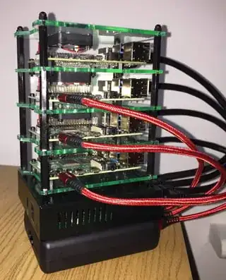

This month, I have built a 4 board Hadoop/Spark cluster following this guide.
I looked at the possibility of buying a PC Power Supply but for a 4-Pi cluster, that seemed like overkill and would generate a clunky solution.
To power it, I bought an Anker 63W 5-port USB Charger and 30cm USB to USB-C cables. There's no need for a USB-C hub and, as you point out, they don't exist in any case.
It's true, that only two of the sockets are rated at 3.0A, the others are described as 2.4A, but even with the draw from the fans that came as part of the cluster case (5V 0.2A) the cluster works perfectly well. I am running them headless and won't be having any external peripherals so I don't foresee any power issues with this setup.

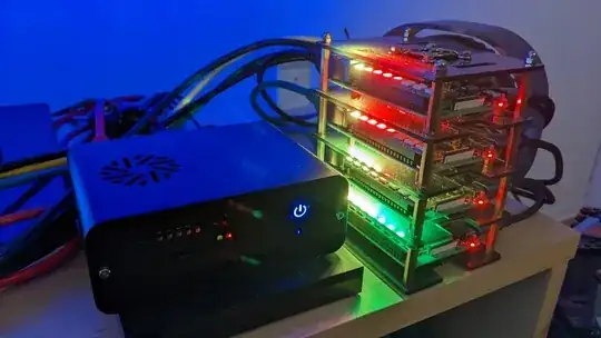

My Docker Swarm Cluster
The manager node in the black case is using an official pi power supply since it has a SSD for its drive. Stay away from "smart" USB ports for power
