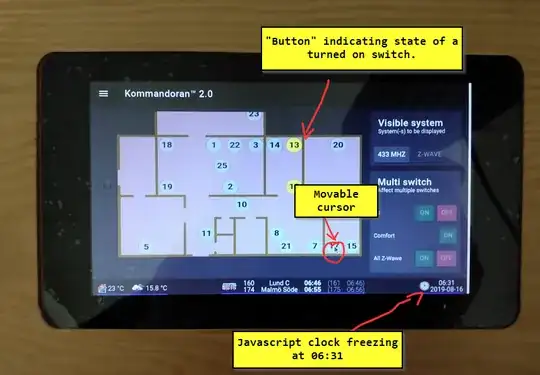

I have a Raspberry PI 3B+/raspbian running my NodeJS (node-red) backend application. My Raspberry is hosting a frontend application (VueJS) as well. I also have a 7" display connected. The purpose with the system is to display a map of 433 Mhz electrical switches in my home.
If I, for example, click on a switch on the display - the system should turn on/off the lamp and indicate the current state. This has been working flawless for months! enter image description here A picture of the display. A javascript clock i the lower right corner.
Since a few weeks, I am facing a really strange behaviour:
Sometimes between 06.30 - 06.33 (6.33 AM) every day, something (??) happens and the browser seems to be non responsive on my 7" display. One thing that is strange is that I am able to move the cursor when touching display. Nothing obviously happens when I click on a button, BUT!, since I have started my Chromium instance like this: chromium-browser --disable-gpu --remote-debugging-port=9222 --remote-debugging-address==10.0.0.4 --user-data-dir=remote-profile --kiosk http://localhost/kommandoran2.0/#/ (in /etc/xdg/lxsession/LXDE-pi/autostart) I am able to remote debug. I can see that correct javascripts are invoked when I click on buttons (in the real world, my switches turns on and off). The problem is that the GUI seems to be semi frozen. At least the GUI in Chrome/KIOSK. The GUI is not updating itself in Chrome

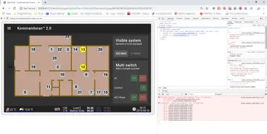

This is the inspector from a Chrome instance on a windows computer in my network when my Pi has been "frozen" enter image description here
Ok, some javascript errors, but they are indicating other things.
Since I am the "developer", I am very sure that I have nothing in either backend (node-red) or frontend (VueJS) which should be able to cause this behavior!
