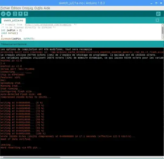

It is possible to flash the ESP8266 12-F with the raspberry UART or I2C pins ? Has anyone ever done this? Thank you.
EDIT: OK it's work, finally I just had big problems with my breaboard and my connections.

It is possible to flash the ESP8266 12-F with the raspberry UART pins ? Has anyone ever done this?
