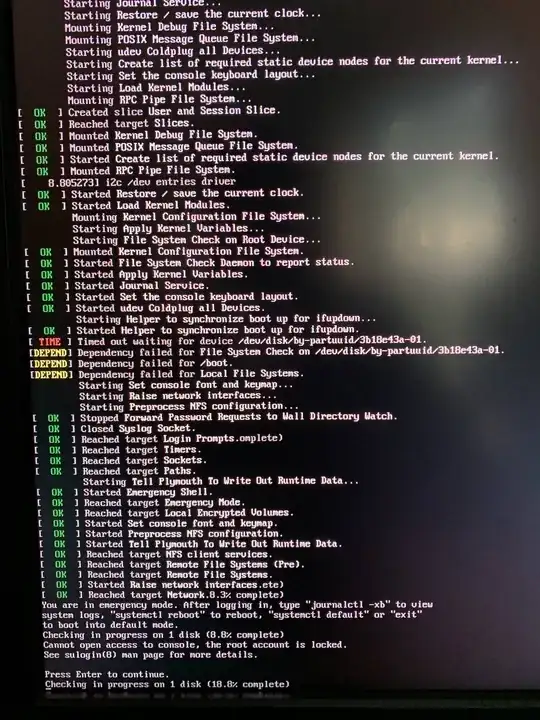

Instead, I've disable quiet booting and observed a few things. First off, when I first boot into the freshly resized disk, I see the following:
What I think is happening here is that the fsck is timing out, and when I allow this to run its course I reboot and get something different. I get as far as this screen:
