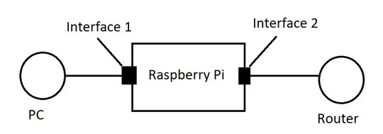

I recently read about hack5s' Packet squirrel, and now I am interested in building a similar device that sits between 2 endpoints (say router and PC) and monitor all the traffic but be invisible to the 2 endpoints. (Figure)
I was thinking of using the RPi's ethernet interface as one interface and a USB to ethernet module as the other.
Then the RPi could capture the packets in either direction, replace the MAC addresses and IP addresses and forward them. At the same time all transactions will be logged.
Could anybody point me in the right direction?

To make a man in the middle attacker with a Raspberry Pi 3B(+) or 4B is very simple. You will use an additional USB/ethernet dongle so you have a second wired interface eth1 available. Now just bridge eth0 and eth1 and you have a complete transparent and stealth device.
Start with a fresh flashed image Raspberry Pi OS Lite and use systemd-networkd to set it up. Just follow to Use systemd-networkd for general networking. You can use section "♦ Quick Step". Then come back here.
Create these three files to configure the interfaces and the bridge:
