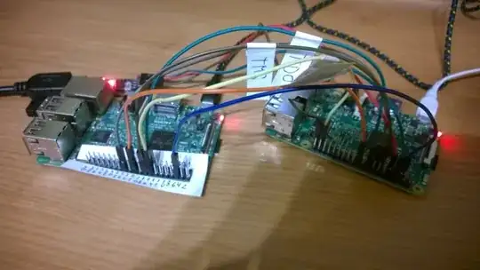

I am trying to debug a Raspberry Pi 3B (rev 1.2) bare metal application using JTAG. I have no JTAG adapter so I am using another Raspberry Pi (3B rev 1.2) as JTAG adapter. I am using OpenOCD and it looks like it's working. I can access all cores but it randomly reports DAP errors.
Connections are simple wires.

How to fix it? What am I doing wrong? Do I need to add some resistor or capacitor on data wires?

The problem could be due to the missing termination / impedance matching on the JTAG signals. Here's the recommended setup:
TCK should be terminated with a 68 Ω resistor and a 100 pF capacitor in series to ground, placed as close as possible to where the signal enters the final device in the chain. TDI and TMS should be pulled to the power rail with 10 kΩ resistors. TDO should be pulled to the power rail with a 10 kΩ resistor and have a 22 Ω series resistor fitted near to the final device in the chain. It is also recommended that a 10 kΩ pull-down resistor be added to the nTRST line to avoid floating inputs.
