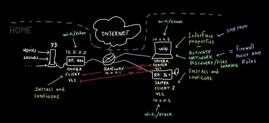

If you want provide files to clients then you want Windows as SMB SERVER:

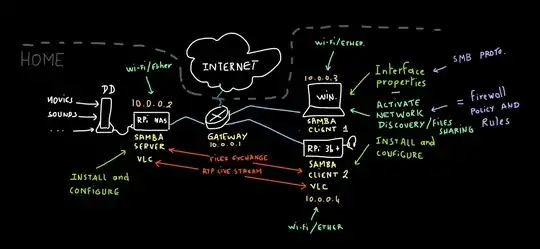

If you want your RPi to access to an SMB server, then you want RPi as SMB CLIENT (testparm, smbclient, nmblookup ... and other binary are provided when you install samba package):
Adapt according to your needs ...
If you want to use a name in place of an IP address for the network access, you must configure a domain name server.
