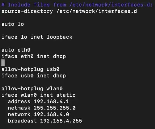

Here is a screenshot of my current /etc/network/interfaces file
network/interfaces
Agustin
  • 146
On your installation you have predictable network interface names enabled so you will not always find classical interface names like eth0. Your wired interface has the name enxb827eb3f0e89. Instead of eth0 you have to use this name.
If you don't like predictable network interface names you can use sudo raspi-config to disable it with "2 Network Options -> N3 Network interface names". If it doesn't help you can edit /boot/cmdline.txt and add net.ifnames=0 to the line.
You can use the wired interface name (whatever name do you use) to configure either a routed or bridged interface. I suggest to use a bridge together with the wlan0 interface so all devices on wifi and wired are on the same subnet. I do not use deprecated ifupdown, managed with /etc/network/interfaces, since years so I cannot help much with this setup to create a bridge. I use systemd-networkd and do it this way: How can I set my pi 3 up to be WiFi AND ethernet router simultaneously?. In that setup I think you could just replace usb0 with ppp0.
