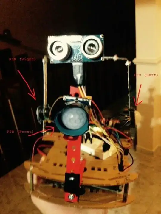

I am currently working on my first Arduino project and I am having some issues that I am seeking help with. The robot I am building must have human following capabilities and to do so I am using 3 PIR sensors (One on the front, one on the left and one on the right) and an Ultrasonic Sensor so the robot won't run into a wall or a person it is following. To handle the motors I am using the Adafruit Motor Shield (V.1)
The way I am trying to make this work is as follows.

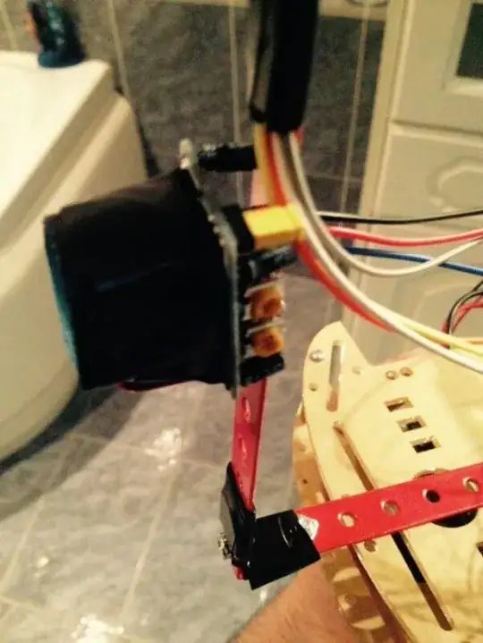

The robot's main PIR sensor is the one attached to the front. If this sensor reads HIGH then the robot will move forward while checking its distance from any objects in front of it in which case it stops and reverses until there is at least 30cm of space between itself and the object in front. The radius of this sensor had to be reduced so that it only reads HIGH if the person is exactly in front of the robot. This was done using carton paper and black duct tape. Two images of this have been provided below in case this has something to do with my issue.
The other 2 PIR sensors attached to the sides will tell the robot if it should turn left or right. If the left PIR is triggered then the robot will start turning left and keep doing so until the front PIR finally reads HIGH, and then it moves forward. The same thing is done with the right PIR except that it moves right. These PIR sensors are handled using interrupts on the Arduino Mega 2560 board as can be seen in the provided code.

The first issue I am having is that as soon as the PIR sensors are done calibrating, the robot starts moving forward by itself. Even if I leave the robot alone inside a room with the door closed, after the calibration time passes the robot automatically moves forward on its own.
The other issue I am having is also with the front PIR sensor. While the robot is turning and looking for a human as seen in the 'turnLeft()' and 'turnRight()' methods, the robot will sometimes move forward toward a random direction instead of towards me.
