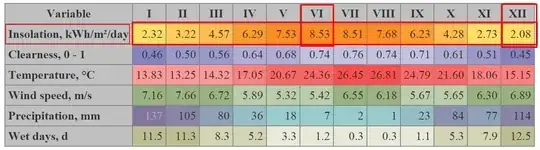

Sunshine hours per day may be found for sites worldwide using the excellent www.gaisma.com The average sunshine hours per day for Iráklion may be found at that link and other locations in Greece can be found here but will probably be similar.
For Iráklion the SSH may be found in the 1st line of the 4th chart.
Average hours/day of equivalent full sunshine = kWh/m^2/day = a peak of 8.53 hours in June and a low of 2.08 hours in December.
Wow! I think that is about as sunny a place in Summer as anywhere on earth not in the polar regions. In Winter it gets about the same SSH as in my city. You can calculate PV sizing for peak summer - but if you want year round operation you should use the worst case winter month and add a bit for bad days.
For Iraklion us say 2 SSH per day so the panels needs to provide 24/2 = 12 x winter average load. So per 10 mA of load yo need 120 mA of panel and if the mean load is 50 mA you need 12 x 50 = 300 mA panel output.
