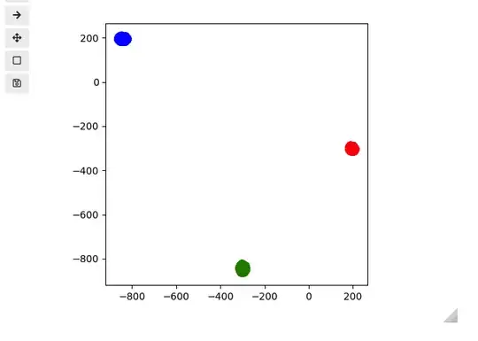

I'm trying to calibrate my MMC5603 magnetometer using MotionCal and the Adafruit SensorLab Jupyter notebook, but my readings seem off. The raw magnetometer values appear to be spread out oddly even before calibration, and they don’t seem to move much, if at all.
Here’s what it looks like before calibration: before calibration

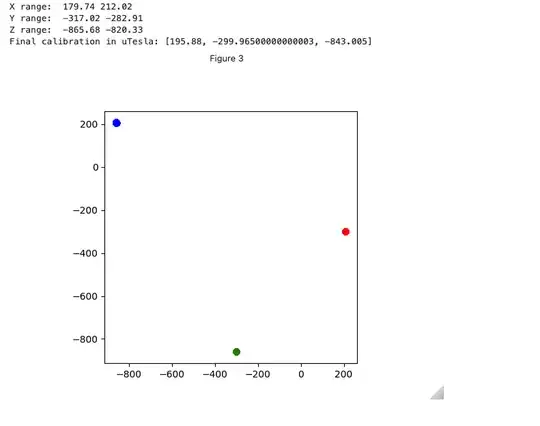

And after calibration, the values become extremely large: after calibration
Even then, MotionCal doesn’t seem to be able to calibrate the sensor properly — the point cloud barely moves when I rotate the sensor.

To perform a calibration, you need to remove stray magnetic fields. I think thats your problem. Almost anything using electricity, around the device, is probably generating a field. Items such as, power point, power supply, motors, computers, phones, etc.

We can work together on this. As you improve you question I can improve this answer. It would be better if we used the before calibration minimum and maximum values. However we can work with your posted data until you improve your question by adding the before calibration minimum and maximum values.
Also, it is important to state your goals. I am going to assume the goal is to create a compass that can only be used with it's X and Y axis parallel to the surface of the earth. And that you do not need to compensate for magnetic declination. And that the inclination of the earth's magnetic field is not significant.
This answer assumes the magnetometer will be used as a compass and not as a measurement device.
Consider manually calibrating the magnetometer and writing your own code. This will provide a better understanding of the process, simplify most answers given here and provide the expected calibration values should an off the shelf calibration method is eventually used.
  1. Find the offset for each of the 3 magnetometer sensors by adding the minimum and maximum values of each then dividing by 2.
    X: ((179.74) + (212.02)) / 2 = 195.88
    Y: ((-317.02) + (-282.91)) / 2 = −299.965
    Z: ((-865.58) + (-820.33)) / 2 = −842.955
  2. Subtract these values from the raw values to adjust for sensor offset.
  3. Find the magnitude adjustment for 2 magnetometer sensors. Pick the X sensor as the reference. Find the magnitude adjustment for the Y sensor.
    Y: ((179.74) - (212.02)) / ((-317.02) - (-282.91)) = 0.946350044
  4. Find the magnitude adjustment for the Z sensor.
    Z = ((179.74) - (212.02)) / ((-865.58) - (-820.33)) = 0.713370166
  5. Multiply the offset corrected Y sensor value by the Y sensor magnitude adjustment found above. Multiply the offset corrected Z sensor value by the Z sensor magnitude adjustment found above.
These values are now calibrated to use with one another. To make a not tilt compass find the inverse tangent of the X and Y values. This maps to only half of a complete circle. To fix this, many computer languages support the atan2() function which maps to a complete circle.
