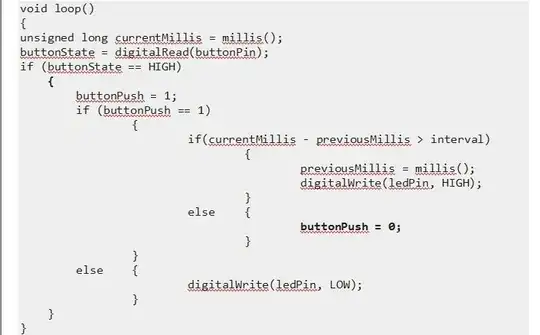

Summary:
A fatal problem is caused by the two lines of code below.
A variable is set and then the same variable is immediately tested to see if it is set. This means that the IF test always passes and the ELSE never happens. As the LED is cleared only when the else occurs, the LED stays lit.
Code:
  buttonPush = 1;
  if (buttonPush == 1){ ...
When the button is pressed you set buttonPush and then immediately test to see if it is set.
As it always is set, the LED never gets turned off as the "else" condition is never met.
Even when that is fixed you have other issues.
I suggest that "expanding" the code along the lines I have shown in (3) below will help you immensely with visualising what your code does.
There are a large number of editors which handle this task in various ways, but just plain tabbing and white space with a basic editor helps muchly.
It seems almost certain that your code will NOT do what you intend when it does work "properly", but there are several issues below that need addressing (one fatal, others less so) - see "ISSUES" below.
Apart from those issues, it's not 100% clear how this is intended to be used.
Options include:
  • Switch is pressed and released quickly (say 100 mS) - LED lights for one second and then goes out.
  • Switch is pressed and held - LED lights for one second then turns off even when switch is held on.
  • Other variants are possible.
At present it will not do any of these.
ISSUES:
(1) You have assigned
long previousMillis = 0;
This should be
unsigned long previousMillis = 0;
Mixing the two types gives an uncertain result. At best, an error will occur when the value returned by millis() exceeds the length of a "long" data type and when types are mixed there is no guarantee that the result will be valid.
(2) I have not checked it, but I'd be wary of the line
if(currentMillis - previousMillis > interval)
as it depend on operator precedence of the "-" being implemented prior to the ">" comparison.
ie this could potentially evaluate as either
" (A-B) > C " .... which is what you intend,
or
" A - (B > C) " .... which, while it is not what is intended, does have a valid if not useful result.
You can rely on operator precedence if you have confidence in yourself and the system or make it explicit as in eg
if( (currentMillis - previousMillis) > interval)
Making things easier for yourself:
This has been edited to match my main conclusion which was already covered above (the problem was not nesting but a test that can never fail - as covered above) but the formatting comments are relevant.
Your code is written in a standard (or usual) manner. Some are able to handle such without problem, but I (and many others) find such layout hard to read and, importantly, easy to bury errors in. The following is overdone - I used existing tabs and expanded it in Word :-) - but to me the following makes it immensely more readable. Layout and style are a matter of personal preference, and there are many opinions re what is "best", but something which allows ease of visualisation of program structure is liable to be useful.
The two adjacent lines
  buttonPush = 1;
are logically grouped together when indented like this at make it clearer that the "set then test" arrangement can never fail so the subsequent "else" where the LED is turned off is never implemented. So the LED must stay on.
buttonPush = 0; is bolded for unrelated reasons.
Russell McMahon
  • 2,421
The direct answer to your first question (LED gets stuck) after formatting and summarizing a section of your code:
  buttonPush = 1;
  else {
     digitalWrite(ledPin, LOW);
is that there's a logic error. You can see that the else clause, turning off the LED, will never be executed because buttonPush is always 1 before you enter this section. I think this is the point @RussellMcMahon was trying to make.
