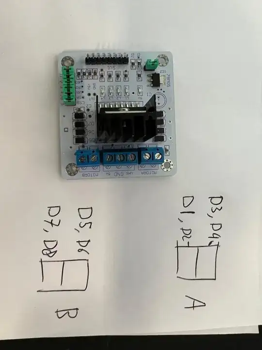

I also have L298N dual bridge DC and stepper motor controller board.

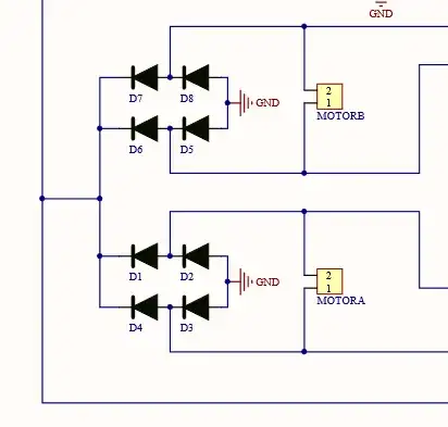

https://cdn.velleman.eu/downloads/25/wpi409a4v01.pdf
source: https://cdn.velleman.eu/downloads/29/infosheets/vma409-schematic.pdf
Is it possible to use this to drive the linear actuator?
