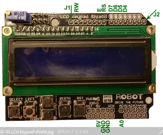

LCD keypad shield
In image, I connected keypad shield with an Arduino Uno by wiring up J1, J2, RW, E, RS, D4, 5, 6, 7, 5V, GND, GND and A0.
I checked that the keypad shield is operating normally with only these 13 connected.

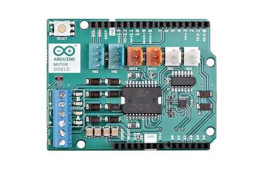

You will also need an Arduino Motor shield, for a motor, something like this:
Motor shield

As can be seen from the photo, the motor shield is stackable, allowing you to have you LCD/keypad shield on top (the screw terminals will be accesible, although you will probably have trouble using the header pins).

Note: For the servo shield you have to supply additional current (see the screw terminals bottom left), and maybe the same for the motor shield. The Arduino by itself (or rather its power supply) can't really supply enough power to move a motor.
