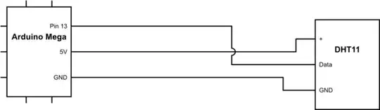

My set up
schematic
My schematic isn't super accurate, the sensor's on the breadboard. LMK your thoughts.

If you are using a standalone DHT11 sensor (Without breakout board) you will need a 1KΩ pullup-resistor between 5v and Data.
The DHT's data pin is an open collector, meaning it can only pull a wire to ground to transmit data. If that wire wasn't pulled up to begin with, it won't have anything to pull down.
If your DHT11 is on a breakout board with the 1KΩ resistor already in place, I would suspect a bad sensor...
