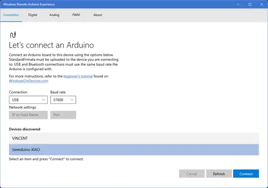

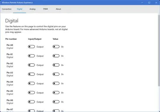

However, when I use Windows Remote Arduino Experience app, board is being successfuly found and I can control pins, retrieve info etc. Screenshot 1 Screenshot 2
