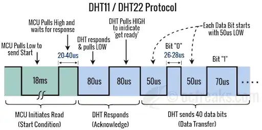

I am exemining code for DHT11 from CircuitGeeks, variant without using lib. The problem is a mismatch between DHT11/DHT22 protocol and signals, which are read from sensor in scetch. Despite this, sketch is working and I would like to find out how.

Looking into the code there is 18 ms of LOW level for initialization. Then about 40 us of HIGH level, it can be considered as time between digitalWrite(DHT11_PIN, HIGH); and TOFF_TIME = pulseIn(DHT11_PIN, LOW); instructions. But then after 80 us of LOW level TOFF_TIME = pulseIn(DHT11_PIN, LOW); it should be 80 us HIGH level. Instead of this, the code is being continued by conditions for checking pulses length, which are responsable for data bits. If pulse length is 26-28 us it's 0, if 70 us - it's 1. I understand that with TON_TIME = pulseIn(DHT11_PIN, HIGH); instruction we will find length of HIGH pulses of data bits only.
Why 80 us HIGH level is passed, however this doesn't impact on interaction with sensor? Does it pass in time of executing instructions from if (TOFF_TIME <= 84 && TOFF_TIME >= 76) to TON_TIME = pulseIn(DHT11_PIN, HIGH); ?
At the end of the 80 µs LOW from the HDT11, pulseIn(DHT11_PIN, LOW) returns. At this point in time, the data line is HIGH, somewhere near the beginning of the positive 80 µs pulse. Now, the code executes the first pulseIn(DHT11_PIN, HIGH).
You cannot measure the length of a positive pulse if you missed the rising edge. Thus, as pulseIn() finds the line HIGH, it will first wait until it transition to LOW, then wait until in transitions back to HIGH, and only then starting timing.
See for example the implementation of the counting loop in the AVR core, or rather the C code that served to generate the assembly implementation. It has three waiting loops:
  • wait for any previous pulse to end
  • wait for the pulse to start
  • wait for the pulse to stop
