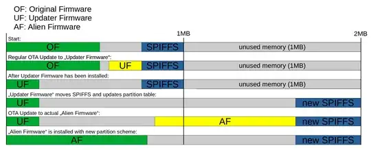

Edit: Illustration
This is the normal OTA routine according to the docs:
and this is what I have in mind:
OTA partition update routine
But for this I need to know the borders of each section, ideally during runtime.

As it turns out the update routine of ESPhttpUpdate.h works just fine when the flash layout changes after an OTA update. At least in my case where the second half of flash memory is unused. If there was a file system in the initial installation, it will be lost.
Though, it should be possible to even preserve the filesystem if it is copied to the right location before a firmware with different partition scheme is uploaded, but I have no need to follow that path now...
to summarize...
  1. A Tasmota firmware was installed on a 2MB ESP8285H16. Since Tasmota firmware for ESP8266/8285 devices uses only 1MB of flash - maybe something like ~500kB sketch, ~400kB OTA, ~100kB FS).
    The second half of flash was unused and the maximum size of a firmware that could be directly uploaded over-the-air was therefore ~400kB .
  2. An intermediate firmware was provided on a http server for the device to update.
    This firmware:
    • was built for a 2MB flash layout (1MB sketch, ~700kB OTA, ~256kB FS)
    • contains nothing but Wifi login and the OTA routine Upon success, this update will leave the flash in the new layout
  3. With the additional 300kB of OTA memory, the device could now be updated to the final firmware. This firmware was built with the same partitioning like the intermediate firmware.
