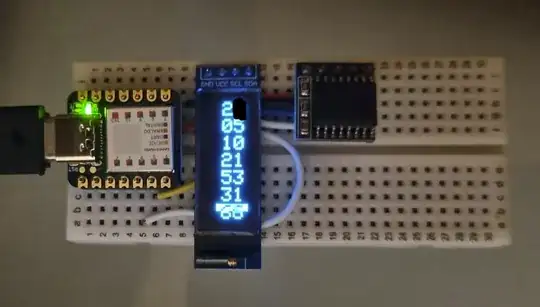

I am building a small art project to display my current age with an accuracy of 1/100th of a second. I am using a XIAO SAMD21, a DS3231 RTC, and a 128x32 OLED screen. Here is what it looks like right now without the battery:
My aim is to fit this and a battery into a locket / necklace. I want to make as low-power as possible so that it can last at least an hour or two on a 75 mAh Li-po. I can't use a bigger battery since it wouldn't fit in the necklace.
I wrote the code to the best of my ability and it looks like it works really well. I just want a sanity check to make sure there isn't a simpler way of doing things. In particular I feel like the calculation of the age in the main loop, the syncing with RTC, and maybe the display updates, could be done in a better way. Maybe there are some things I do with interrupts and the 'alarms' in the RTC? Just power on the display every other second maybe. I am also considering using an epaper display and removing the power LED.
The code is attached here. I use the Adafruit libraries to drive the SSD1306 on the OLED screen, and one of the DS3231 libraries to interface with the RTC. Parts of it are adapted from examples, so there may be some extraneous imports or declarations I don't need.

I see quite a bit of floating point computations here. Since the SAMD21 doesn't have a floating point unit, all float operations are implemented in software, which can be quite expensive. As an optimization, I suggest to stay as much as possible in the integer realm. For example:
uint32_t total_minutes = total_age_secs / 60;
age_secs = total_seconds - total_minutes * 60;
uint32_t total_hours = total_minutes / 60;
age_mins = total_minutes - total_hours * 60;
uint16_t total_days = total_hours / 24;
age_hours = total_hours - total_days * 24;
age_years = total_days / 365;
uint16_t remaining_days = total_days - age_years * 365;
age_months = remaining_days * 12 / 365;
age_days = remaining_days - age_months * 365 / 12;
Note that there is some rounding here: a day is assumed to be exactly 86400 seconds instead of 86399.9999 (I don't know where you found the number 86401.505), a year is assumed to be 365 days, and all months are assumed to be equal. If you found this approximations too rough (mostly the year), you may use 365.25 = 1461 / 4 days per year and 1461 / 48 days per month. You can do this by replacing the last four lines with:
age_years = total_days * 4 / 1461;
uint16_t remaining_days = total_days - age_years * 1461 / 4;
age_months = remaining_days * 48 / 1461;
age_days = remaining_days - age_months * 1461 / 48;
