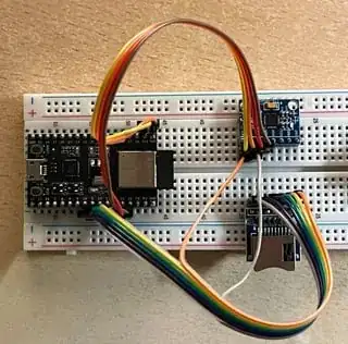

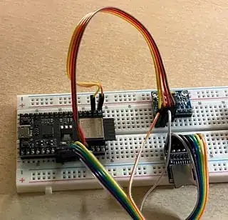

I'm attempting to acquire angle values from an MPU6050 IMU sensor using an ESP32-DevKitM-1 microcontroller.
My setup contains the ESP32 board, the MPU6050 board, and an SD card reader to save the readings from the sensor:

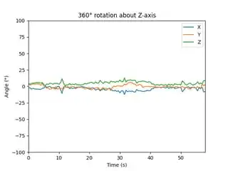

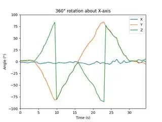

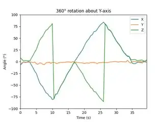

As a test, I rotated the sensor 360° slowly around each one of the 3 axes, and saved the continuous angle readings during each rotation:
The time interval between each reading in the plots above is ~0.2 s.
The first issue is that a rotation about the Z-axis visible in the last graph above appears to not cause any appreciable change in any of the angle readings.

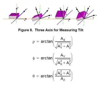

In fact, one of the main sources listed in the original posting that describes in detail the process of calculating the filtered angle values, also provides a visualization of the angle values acquired from the sensor:
Are these "tilt" values related to Euler angles? Is it possible to convert between the two?

The formulas you are using look plain wrong. There are a few issues that stick out:
  • Rotating along z has no effect on the accelerometers. Any formula that pretends to give you the three Euler angles out of accelerometer data can only be wrong. You need a magnetic compass to get the yaw angle, otherwise you would have to rely solely on the gyros, which are prone to long-term drift.
