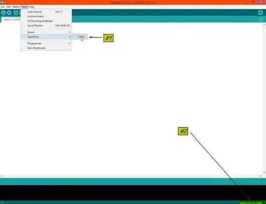

It sounds like you have incorrect drivers or the wrong COM port (USB) selected in the IDE
Both are easy to fix. I'd imagine that it would be the COM port.
IDE
To do this:
Tools → Serial Port → [COM port... try a few different ones. Also you can use device manager to see which one disappears when you unplug your Arduino]
Few notes on photo:
#1. The selector for the COM port. Choose which one your board is on.
#2. That shows the COM port selected and board. I don't have my UNO connected: ignore that the COM port isn't showing up on the menu.
