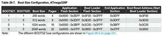

For devices with an Atmega MCU and no pre-installed bootloader, the answer is NO - it is not possible to install a bootloader without a physical programmer.
If there is a working bootloader, but not the one you need, it might be possible under some circumstances.
Lets assume an Atmega328p has a current bootloader that is only 512 bytes large (4 pages) and resides at 0x3F00-0x3FF and BOOTSZ=11.
One might use the current bootloader to program the new bootloader (also 512 bytes) into the application area just below the current bootloader to address 0x3E00-0x3EFF. Now, if the current bootloader is capable of changing fuses BOOTSZ=10, the next time a reset occurs, at least I think so, the new bootloader at 0x3E00 will be startet. The bootloaders should not overlap each other for this to work.
