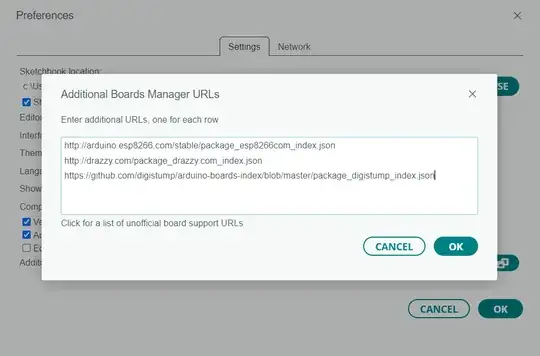

Hello there I am trying to install Digistump library to support ATTiny85 by digispark. But I am encountering a problem when trying to install Digistump AVR boards after adding an additional board URL preference as the library doesn't shows up after searching.I dont know what's the problem even after I tried from the fixes from other solutions across the web. enter image description here

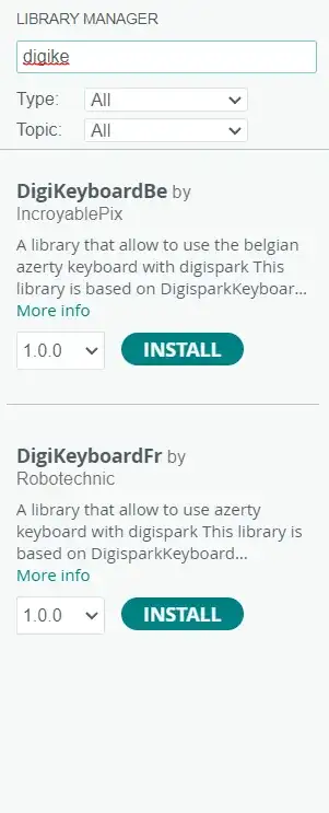

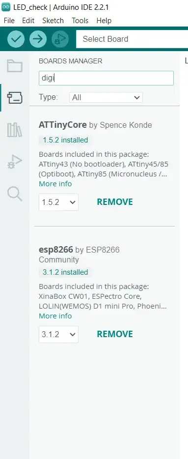

So, I made an alternative method to work the board by installing ATTinyCore library. But it doesn't support DIGIKEYBOARD actions. So when I try to download from library manager there is only packages for AZERTY & Belgian AZERTY layout. enter image description here enter image description here
So for me I need a package that support QWERTY layout. How to install the library.?

The description of DigiKeyboardFr says it is “based on DigisparkKeyboard library”, and gives the link to that library. DigisparkKeyboard doesn't seem to be available from the Arduino library manager: you will most likely have to install it manually. Manual installation of Arduino libraries is widely documented.
