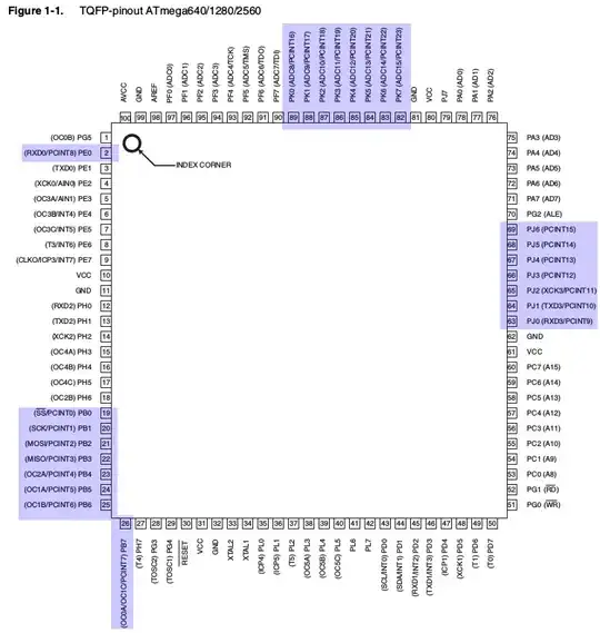

Only some ports on the Atmega2560 support pin-change interrupts, specifically ports B, E (bit 0), J (bits 0 to 6) and K.
Looking at the reference schematic that means that these pins on the board are supported:

Thus you can see that D10 to D12, which you say works, are in that list. Other random ones would not be.

Atmega2560 pin-outs
Atmega2560 pin-outs

On the ATmega1280/2560, only ports B, J, F, and K have pin change interrupt capability. These map approximately to pins 10 through 15, 50 through 53, and A6 through A15 (although part of port J is unmapped to Arduino pins, therefore PCINT11 through PCINT15 are unavailable on the Arduino Mega/Mega 2560).
