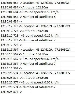

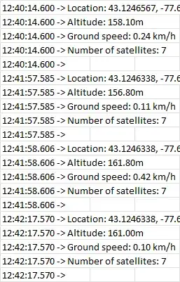

  2. Once the GPS has connected, it does not appear to stay connected in a consistent manner. I've attached a part of the SM printout with time stamps. The time between printing varies from 1s to tens of seconds, to over a minute. All with 6+ satellite connections. enter image description here enter image description here
Being that there are no delays in the code to regulate the frequency of printing to the SM, my thought is that the inconsistent gaps of time between printing come from either:
  1. an unstable connection to the GPS, which I would have no clue how to solve. Or, more likely,
  2. something wrong with the way the GPS.available() function is structured in the library.
