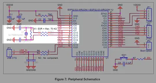

I have designed a PCB with this SCH for RTC. But I don't know how I can activate an external 32 KHz crystal with Arduino IDE. Please tell me how.

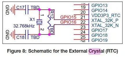

From the ESP32-S3 documentation in section 2.4.2:
ESP32-S3 supports an external 32.768 kHz crystal or an external signal (e.g., an oscillator) to act as the RTC sleep clock. The external RTC clock source is used to improve the timing accuracy and thus reduce the average power consumption, but will not affect the functionality.
This document also contains a schematic:
... it is assumed that the schematic in the question is that of the ESP32-S3-WROOM module accounting for the differences between the two schematics.
