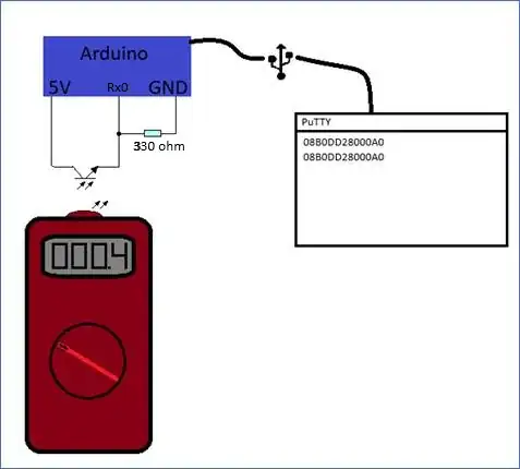

I have an Amprobe 38XR-A (sometimes seen as a meterman), these DMM's have a IR RS232 port on top and transmit a HEX code. Using the official cable I get a hex value of:
08000400500A0
I am attempting to read the IR RS232 via Serial1 of a pro-micro and display the output via Serial, but am getting an incorrect HEX code of:
6C666196665665F6793D
I have tried changing the resistor, in case it wasn't turning on/off fully with no change to the output (unless its a drastic change, then nothing is seen).
A buffer size of 15 appears to give repeatable results and is inline with the specification.
In an attempt for repeatability I have a test lead between the common and ohm port of the DMM.
Set-up:
Wiring diagram
Arduino Code:

Additional links: Output Codes PDF DMM Manual IR photodiode

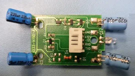

Original IR receiver circuit. Original IR
