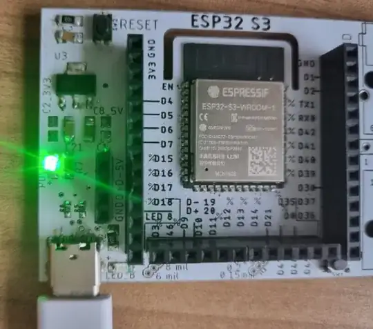

I am designing a pcb for ESP32 S3 wroom-1 for testing pins which are safe to use.
My PCB look like this:

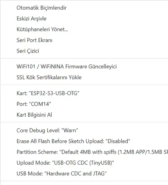

I program ESP32 S3 via USB interface gpio19 "D-" gpio20 "D+". When I plug in my usb, Arduino ide brings wrong name for my Esp32 board. By the way I use USB TYPE C. Everyday it gives different names. Correct one is "ESP32S3 DEV MODULE".
How can I set it to select the correct module automatically on Arduino Ide as ESP32S3 Dev Module?
WRONG 1
WRONG 2
WRONG 3
same board different names. interesting

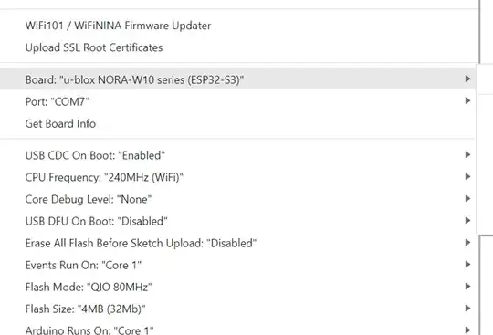

VERY IMPORTANT EDIT: after investigating this issue a little more I have came to realisation that so called "random board names" that show up all have the same VID and PID values. The problem was not the incorrect VID and PID values for your board, the problem was that a bunch of other boards also have the same VID and PID values. A simple yet effective fix would be to assign random names to all the other ones than the one you want to use. Just edit the
adafruit_qtpy_esp32c3.vid.0=0x303a
adafruit_qtpy_esp32c3.pid.0=0x1001
lines for every board other than what you want to use. But never forget to change this text file if you ever start doing long-run development with one of the other boards. Or the other boards (such as u-blox NORA-W10 s3" won't be auto detected.

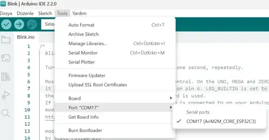

After an Arduino IDE update 2.2, something was solved, yesterday (30,08,2023).
There is a new edit button appearing on the board selection menu and then Arduino ide recognises esp32 even after plugging out and in again.
