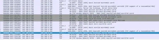

I'm still struggling with this problem. At this moment, everything is setup and configured on the microcontroller side. The microcontroller can connect to any online test MQTT broker via ssl/tls protocol. I have checked that and double checked. Everything is good on the microcontroller side. My MQTT broker is configured to use TLS v 1.2 it is deployed live, the cetificate is valid, it is generated by the zerossl trusted authority and it just works. I can connect from the test clients to my Mosquitto MQTT broker. I have tried multiple clients and everythig works fine. At this point, I have verified that client is valid and server is valid, both can connect to another party using TLS secure protocol. But, when I'm trying to pair my microcontroller with my Mosquitto MQTT broker - TLS SSL error is thrown, saying that the handshake failed. ssl tls 1.2 error ACCEPT_SR_KEY_EXCH ssl handshake failure. I have tried to debug it using the Wireshark, but there are no details at all. when I try to debug the SSL/TLS using the Wireshark, I see that there is a Client Hello, after that the Server Hello, then Certificate, Server Key Exchange, Server Hello Done and it repeats in a sequence again:
any help is appreciated.
seems like you have made quite a progress. Frankly, I believe that the problem lies behind not storing your private key in the ECC608.
If the private key is not correctly stored in the ECC608 TLS Handshake will fail. You mentioned the ECC608 is unlocked by default. You're correct that to use the secure functionalities of the chip, it has to be locked. However, as far as I know once it's locked, it can't be unlocked. Make sure you've followed the necessary steps to store your private key in the ECC608 and then locked it to secure the key. I think you can use ArduinoECCX08 library since it seems to have ECCX08.begin(), ECCX08.lock(), ECCX08.generatePrivateKey(slot) functions. Your approach to generating the CSR directly on the MKR WiFi 1010 device is on point. This method ensures the private key never leaves the device. Consequently, only the public part is sent to the CA, even if it's self-signed. With the CSR, obtain your device certificate. This certificate, coupled with the private key securely housed in the ECC608, should facilitate the TLS handshake.
TL;DR: Make sure that you've stored the private key appropriately in the ECC608. Before locking the ECC608, test to ensure that the private key functions as expected. Check your MQTT Broker Logs for further debugging (when provided and when I get time for that I will try my best to pinpoint the error) and try using WireShark to capture SSL traffic.
That is as far as my knowledge goes, all the best luck to you. I hope that I could be of help dude.
